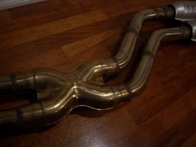

Postby Leo_328i » Fri Aug 22, 2008 5:41 am
Sorry I was refering to this...
Its probably better to call it an X-Merge
Leo_328i
Posts: 37
Joined: Wed May 28, 2008 2:39 am
Re: X PIPE?
Postby MIKEGTR » Fri Aug 22, 2008 8:00 am
that is an x pipe
u don't need it

Re: X PIPE?
Postby fcvapor05 » Fri Aug 22, 2008 11:18 am
Leo_328i wrote:Sorry I was refering to this...
that is an x-pipe. Like Mike said, you don't need it... it isn't going to help you make power.
