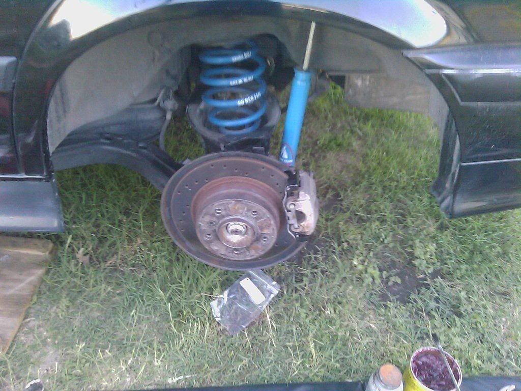

1. Safely Jack up the side of the car where the work will be performed, and chock the front wheels to keep the car from rolling.
a. Remove lug bolts (17mm) and remove the wheel.
2. Remove the screw which secures the rotor to the hub (6mm) Allen socket.
a. Remove the Caliper by loosening the 2 guide bolts with the (7mm) Allen socket.
b. Next remove the 2 (15mm) bolts holding the caliper bracket to the trailing arm.

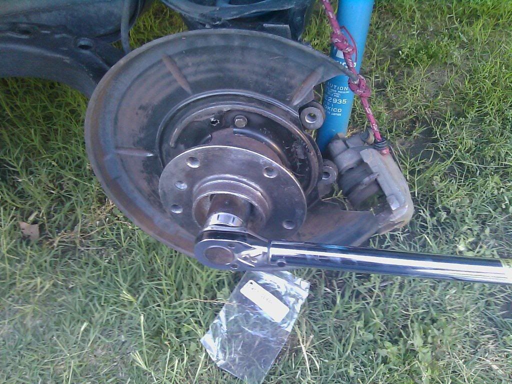

3. Bend the tabs back on the lock nut with a screwdriver a hammer may be required.
a. Use the emergency brake or put the car in gear. This will keep the axles from rotating.
c. Now break out your (30mm ½) socket and breaker bar and remove the lock nut.

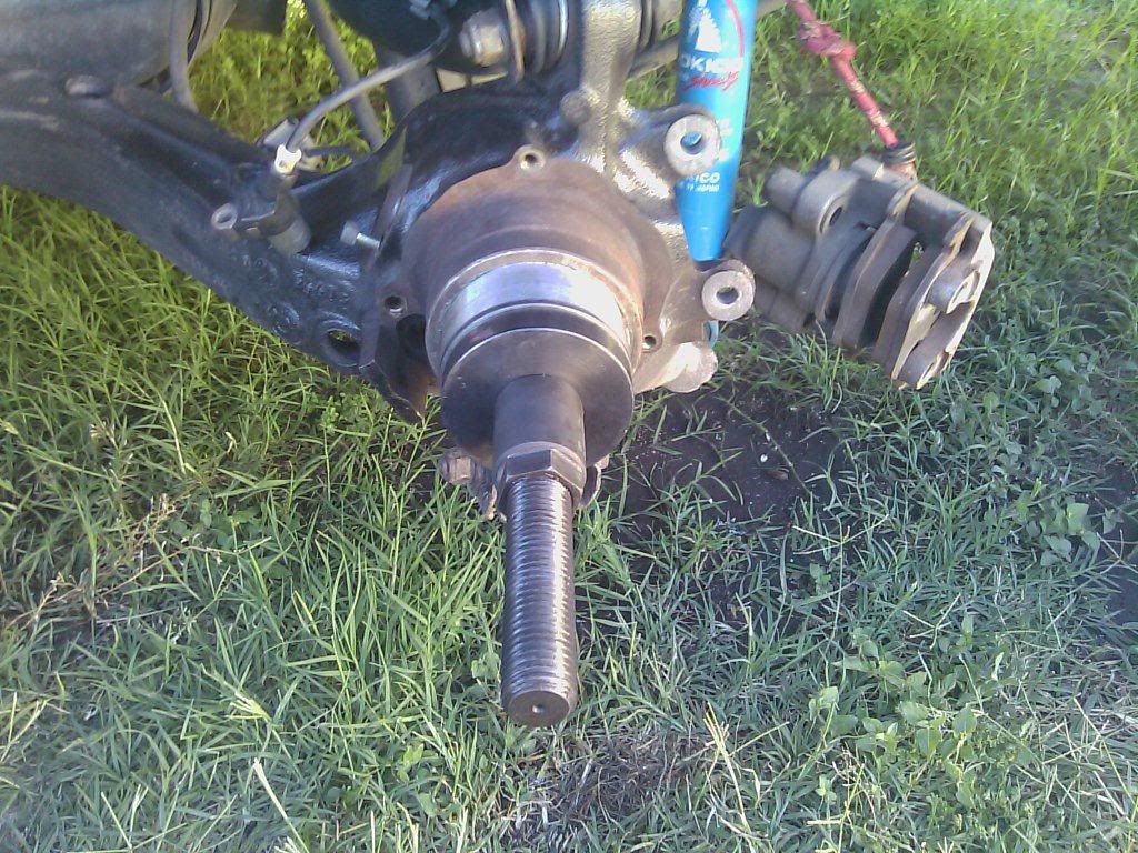

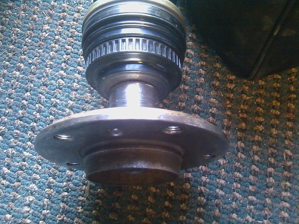

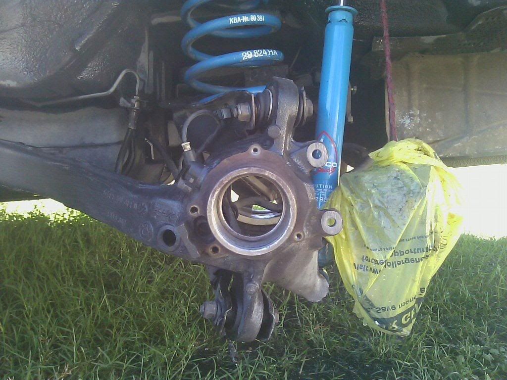

4. Removal of the hub should be pretty easy mine just fell out. If yours seems hard to pull out simply bust out the b90 tool and follow the provided documentation with the equipment.
a. Removal of the inner race which is seized onto the Hub can be an easy job with the right tool the Dremel with a metal cutoff wheel is a good choice. This will relieve the tension from the inner race. A vice will keep it from moving while doing this. Don’t cut into the HUB!
c. After a nice cut go ahead and take a nice sized screwdriver and a hammer give it a whack or 2 it should snap and break free. Be sure to clean up your Hub with a good cleaner to remove any old grease.

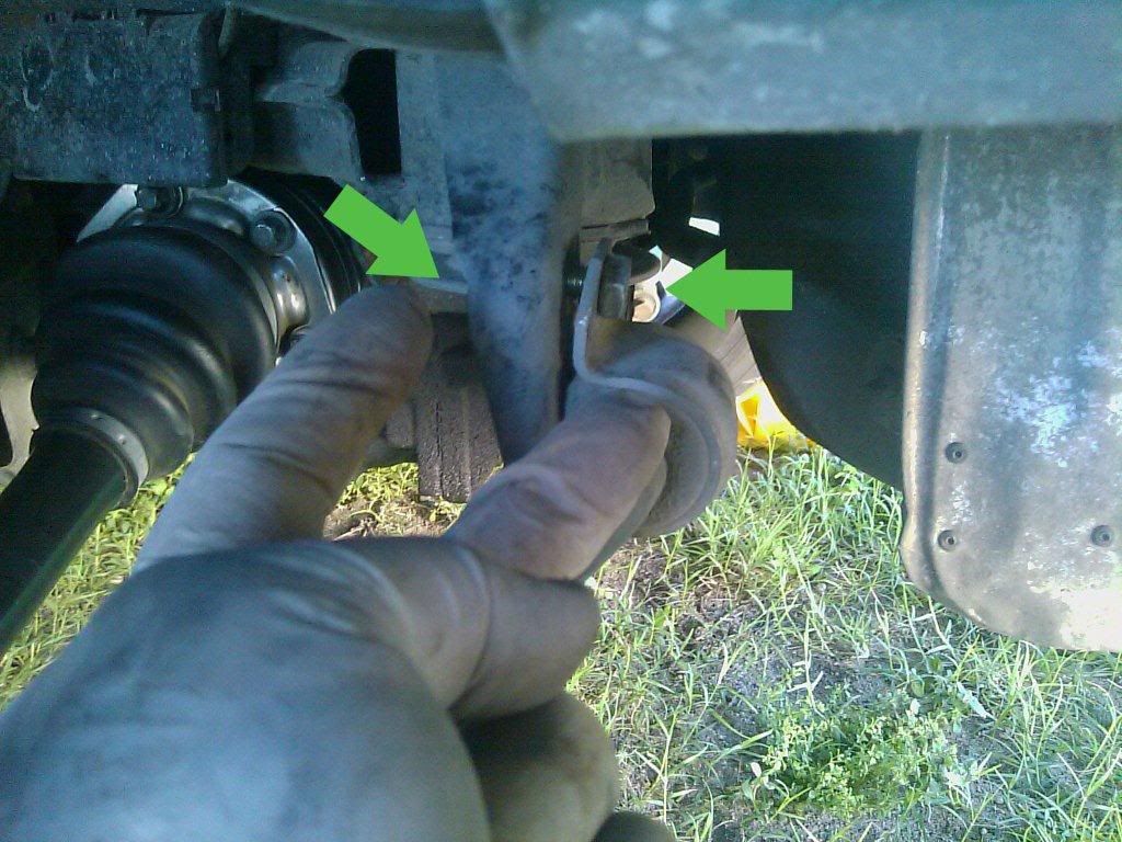

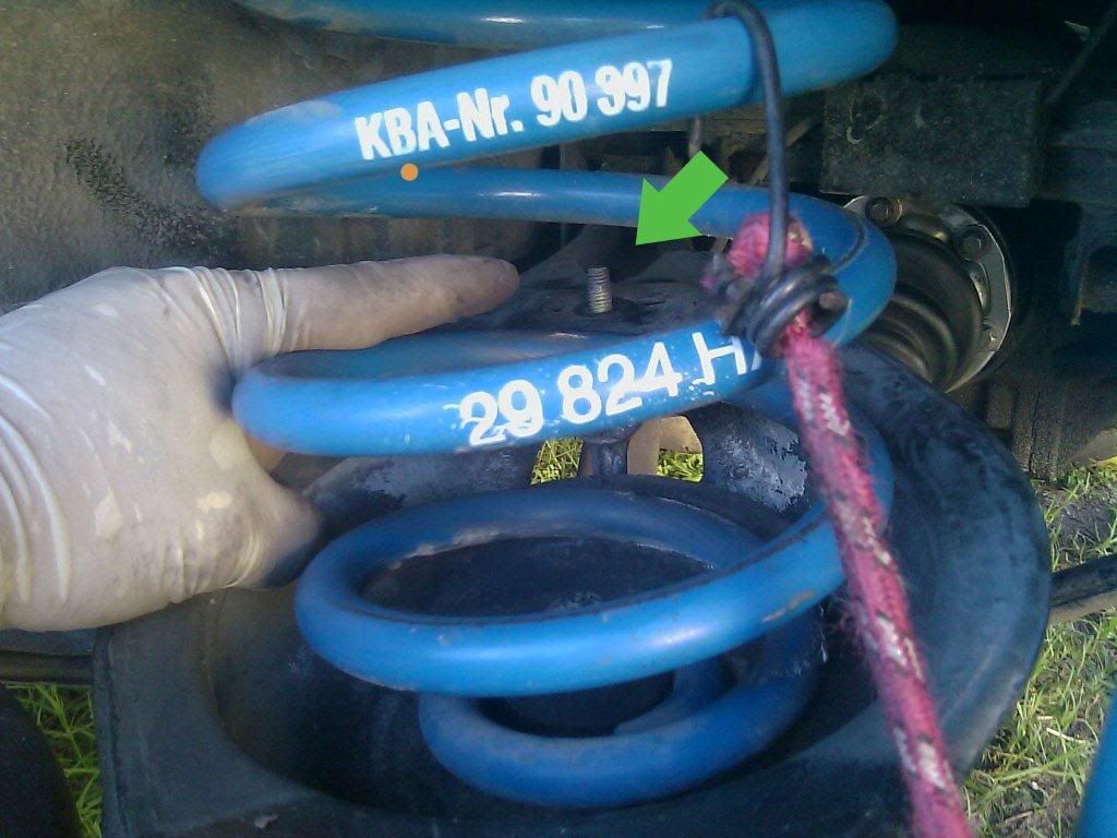

7. Now loosen the rear sway bar work side only! The first picture (a) shows the removal of the clamp there will be a bolt and a nut both (13mm). The second photo (b) shows the removal of only 1 nut sized at (13mm). Move this out of the way by pulling down.

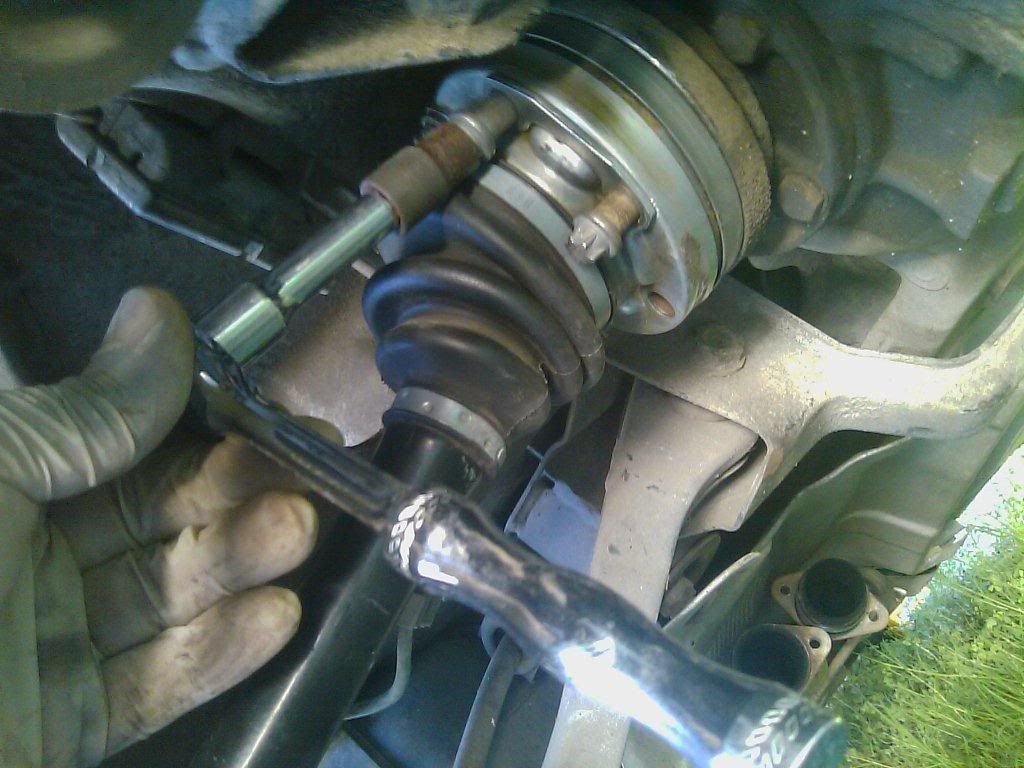

8. Lock the axle by putting the car in gear or using the E-Brake.
a. Remove the 6 Torx bolts holding the axle to the differential using E-Torx (external Torx) socket size #12. Remove the axle now would be a good time to clean up the Axle and ABS ring.

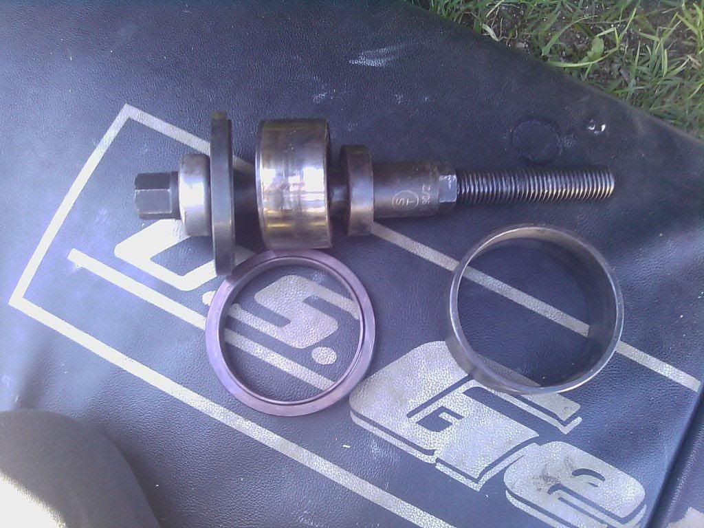

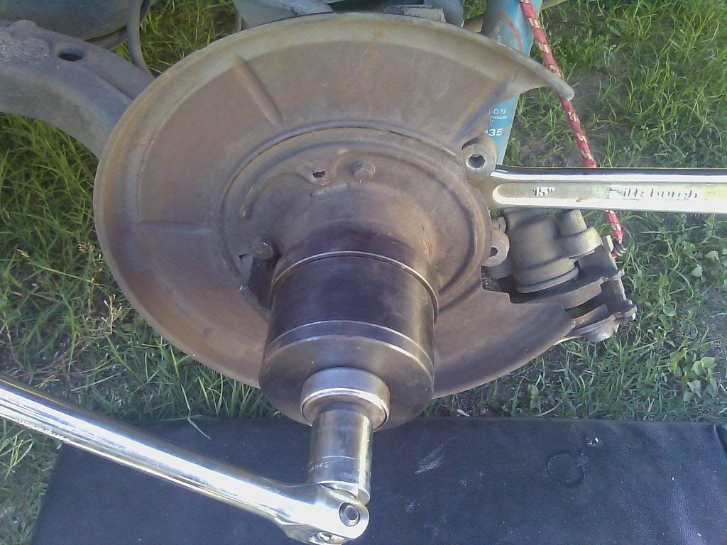

Now’s a good time to remove your e- brake setup springs and all. Get the Sir Tools B90 tool set and begin to extract the bearing from the axle housing. Be sure to grease up the threads this will make the extraction go much smoother. I used a 27mm socket with breaker bar and a really big crescent wrench since I didn’t have a wrench big enough.

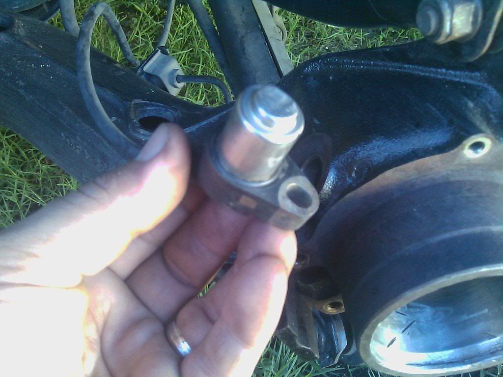

11. Be sure to clean the ABS sensor and remove it before installing the bearing as it should be damaged by the plate used during installation.

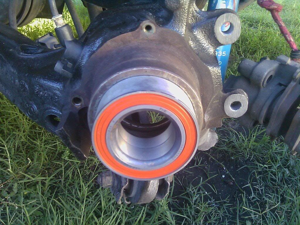

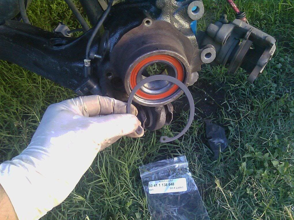

12. Get the new bearing out of the freezer and be sure not to pull out those inner races you do not want to do that it so be careful handing it.
a. Begin by slightly sliding in the bearing making sure its strait and not cockeyed look at it at all angles if need be.
c. Now setup the Sir Tool kit again and be sure it’s all lined up strait and begin the installation while the bearing is still cold.
f. Now install the retainer ring to keep the bearing in place Pn: 33411138648.

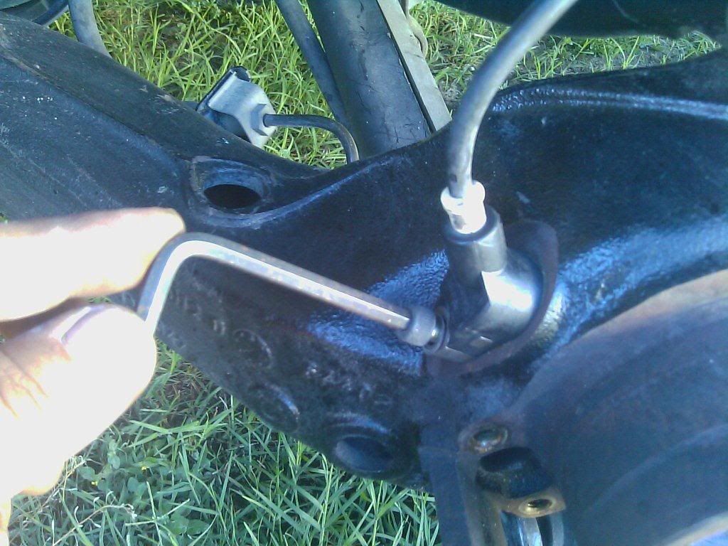

13. Now you can reinstall the ABS Sensor (pictured in 11a) and torque it down hand tight will do.

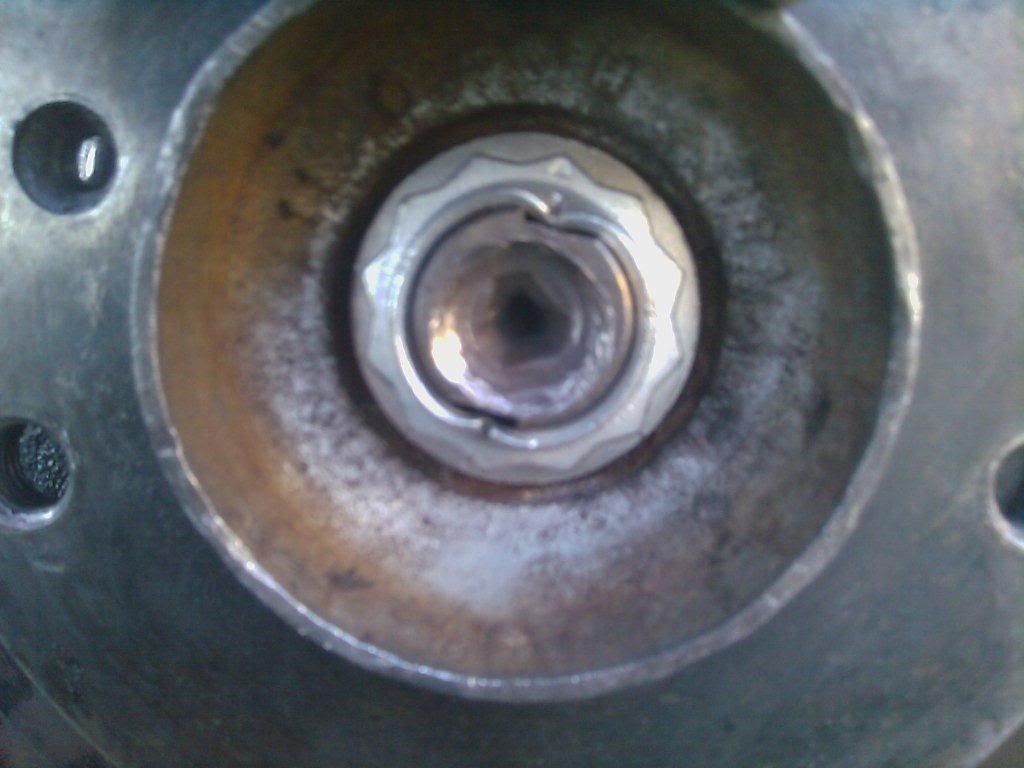

16. After installed throw on the (30mm) locking Nut torque this down to the manufactures specs in your manual
17. Now the nut is torque down to spec. Grad a flathead screwdriver and knock the nut as pictured. This will keep it from coming loose.
