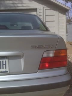

I'm sure almost everyone knows how to do this....but just in case you didn't know how to take off your badges and clean it up....
You'll need:
Dental Floss or fishing wire
adhesive remover
clean rag
Before:

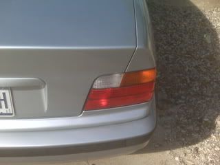

After using the floss to cut through the adhesive:

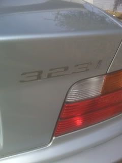

Then the finished product after using the adhesive remover to get rid of the extra adhesives:

Exactly how i did mine. I used Armor All bug and tar remover to get the left over adhesive off, It took a couple squirts though.
