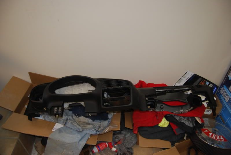

Apparently I have become quite proficient at getting the dash of an e36... I had it out in a little over 30 minutes.
Work Space for the day:
Custom Tools for the three effing bolts in the front defrost vents:
1 SK 7mm sock cut off so JUST the head of the bolts fit in it. 1 chinese brand wrench heated and bent with a torch to reach the drivers side bolt.
If you have never done this task... lucky you!
No mas!
Black will look SO much better!

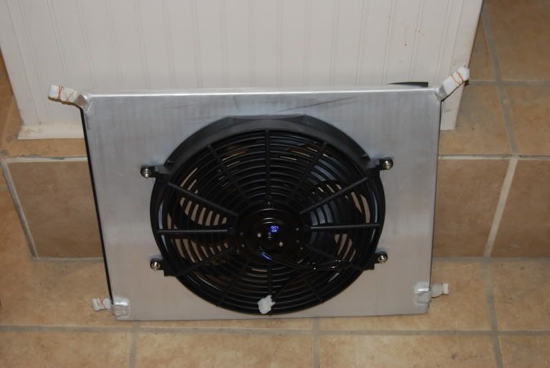

I am going to TRY to see if I can get this to go over the radiator support and use the vette style airbox.
We'll see...

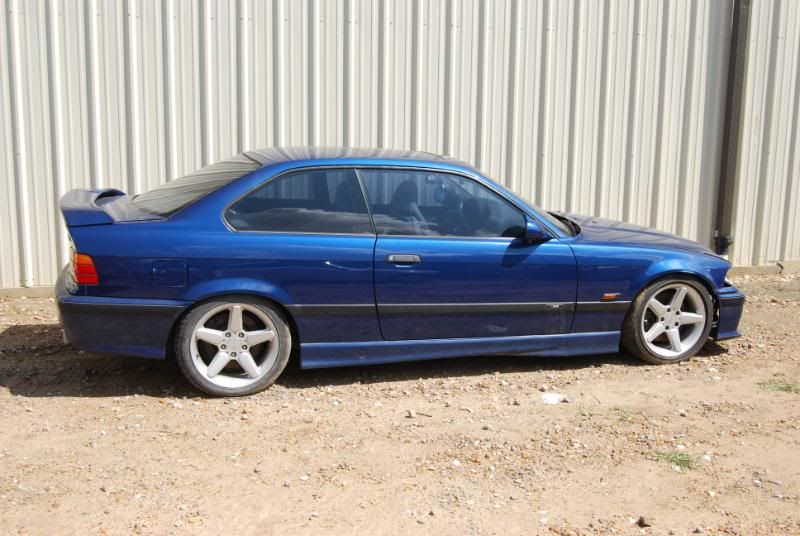

The '95 M3 shell is FORSALE!

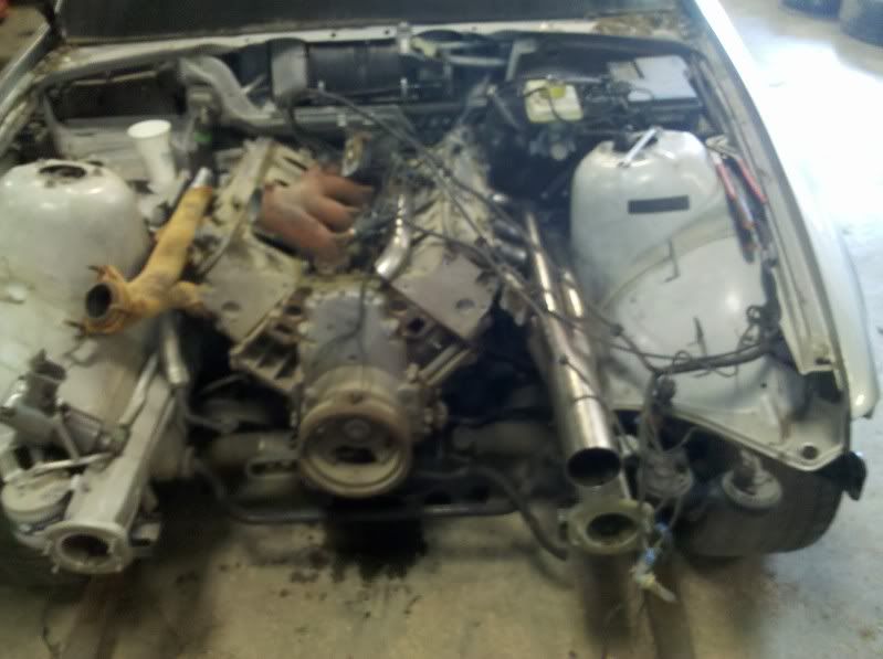

The collector needs to be moved back a little bit to clear the core support and the hot side plumbing.
The formed collectors SUCK!!! I am ordering a set of slip on collectors and running 2.5" hot side piping to a t4 turbo flange.
A smallish T70 .92 A/R turbo has been ordedred.
Needless to say, turbo lsx e36 m3. Somehow this swap makes this much easier then I had thought. I also noticed that you can indeed use the truck manifolds flipped forward with slight modding on the drivers side. Moddification takes 10 minutes.

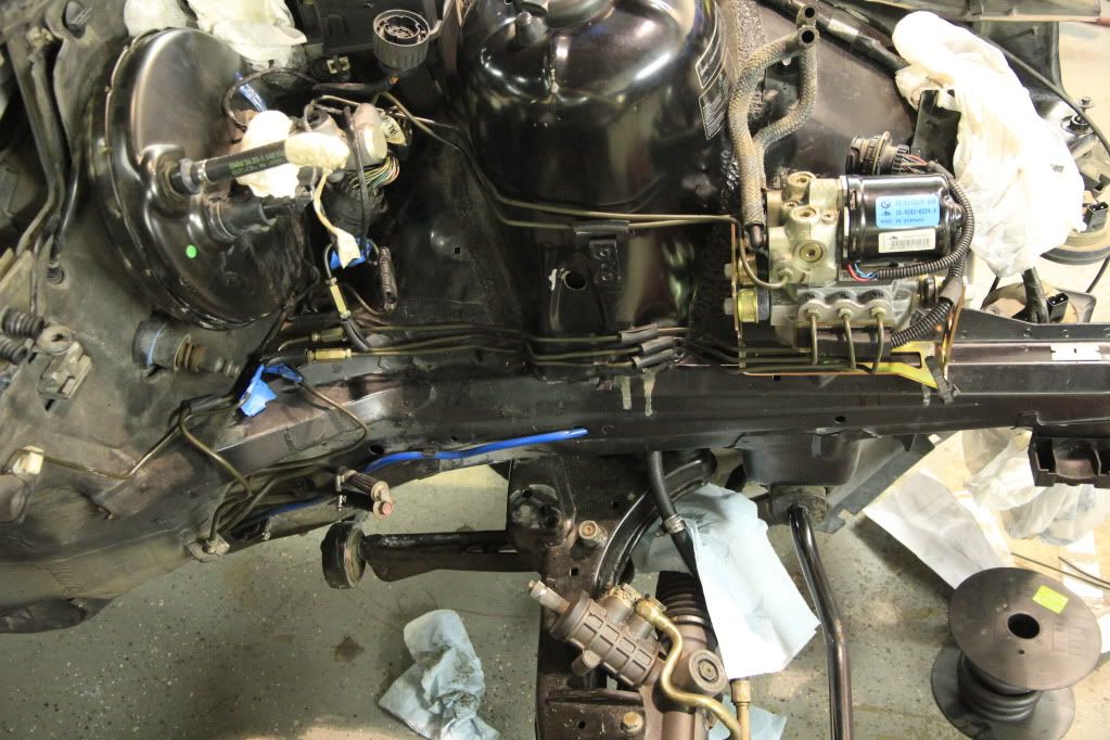

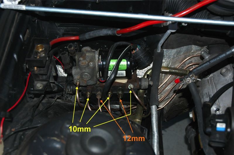

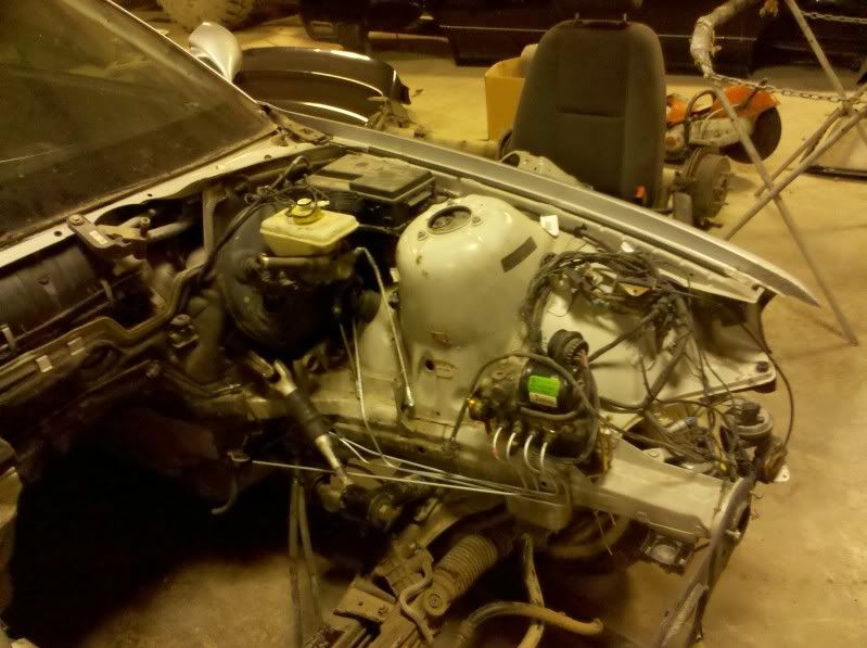

So Thanks to Braap there is this trusty diagram:
I'm going to measure and order fittings to effectively delete the ABS for the moment.
I WILL have ABS on the car, but I'm trying to get this stupid thing done. The ABS when it comes back will be in the form of a C5 Z06 ABS unit.

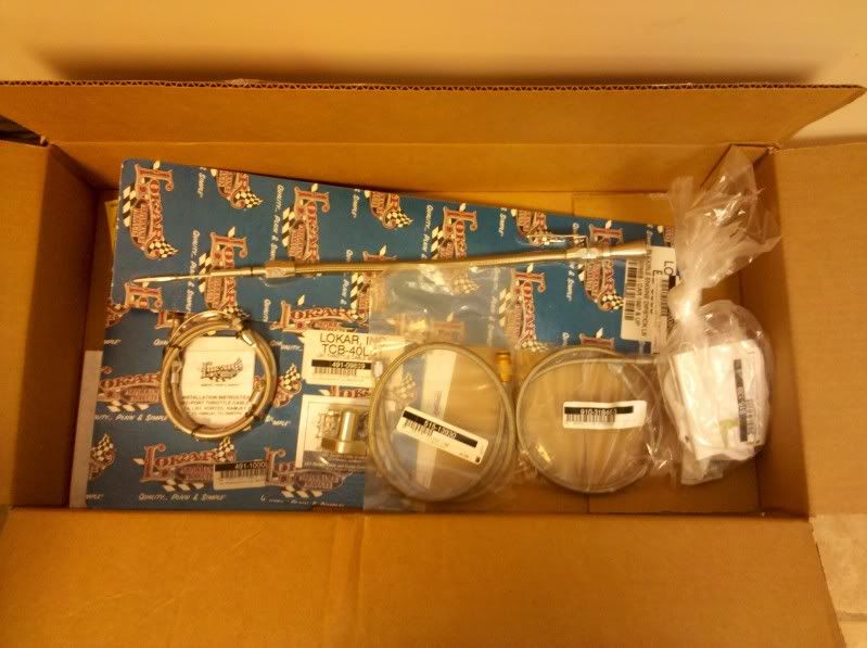

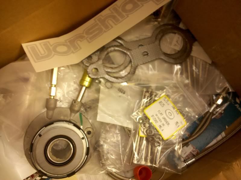

Got some parts in today from Speedway Motors:

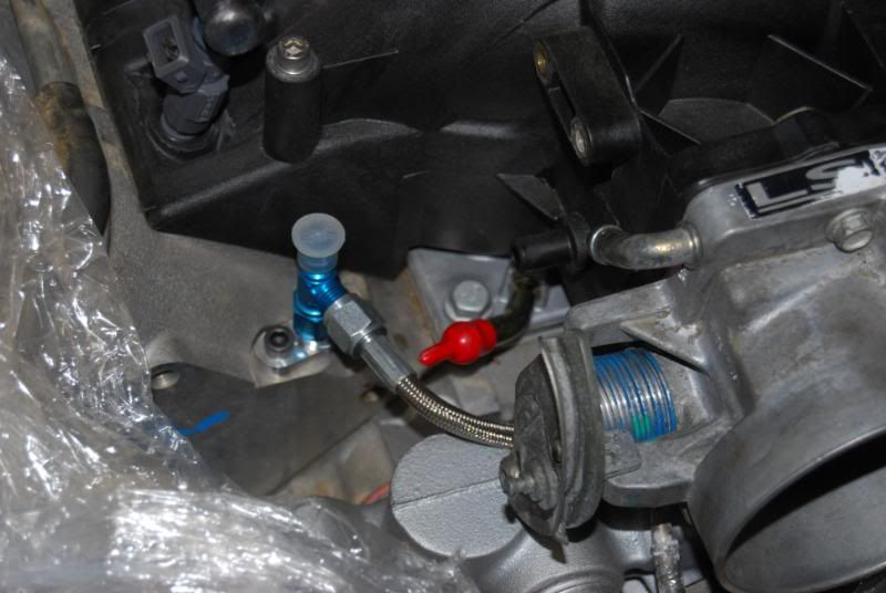

515139 TOOL - T56/LS1 CLUTCH LINE
51513930 30" T56/LS1 CLUTCH LINE
5151399-36 T56 RELEASE BEARING BLEEDER
Selected Kit Components
Sku Description Quantity
91031846-3 36" BRAKE LINE STRAIGHT 1
6174043 AN3 TO 10mm-1.5 FITTING 1
6173642 3/8,10mm CRUSH WASHER SET/5 1
8352200063 1/8"BLEED RPR/ASSY SNGL 1
6174133 1/8"NPT TO #3 BRAKE FITTING 1
6174143 #3 TO 10mm X 1.0 MALE JAPAN
4911000LS1 36"THROTTLE CABLE LS1
4915008 LOKAR DIPSTICK - LS1 CHEVY
49109899 98/99 LS1 LINKAGE CAM SINGLE

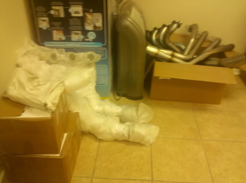

UPS truck came by the shop today and delivered EKnight's Vorshlag kit and my headers!
Great packaging!

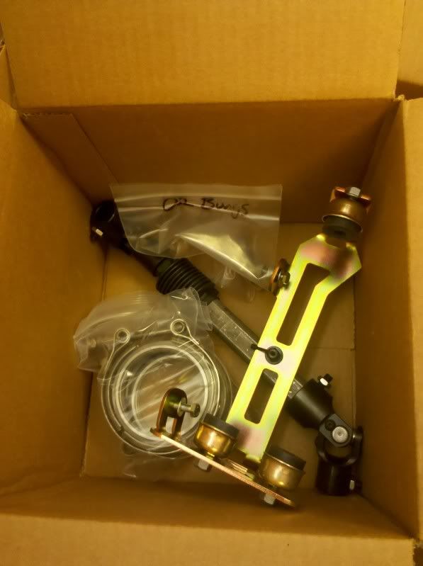

Big Brown Truck came in today with the rest of my Vorshlag bits!
Steering shaft, 4 Channel ABS bracket, and the vBands and what not for the headers.
I also got all of my stainless hardware for bolting on the intake, accessories, and what not. so I should be getting close to having everything to get the motor into the car!

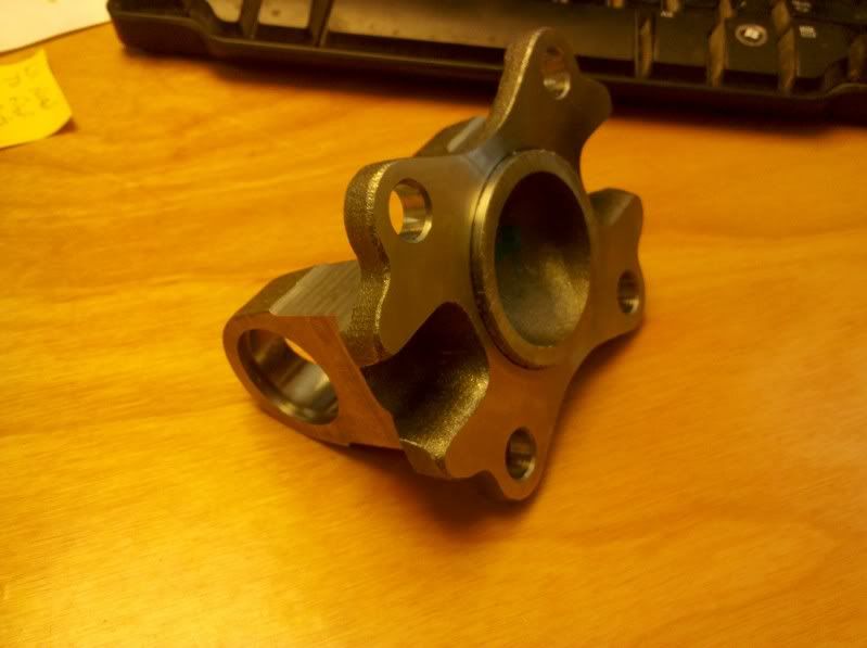

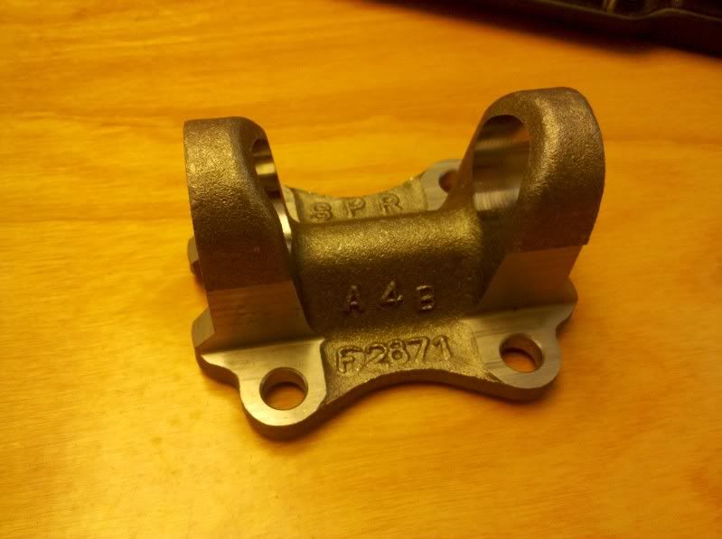

Got my Flange in last week from JTR, just now took it out of the package!
GREAT STUFF MIKE!
They also shipped their product very very quickly!

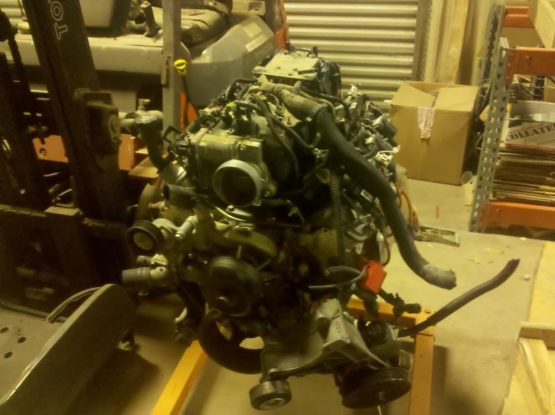

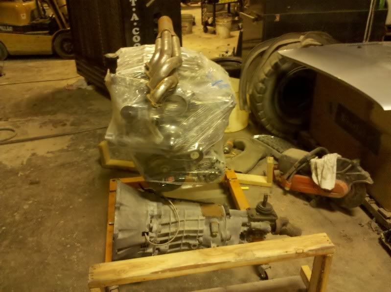

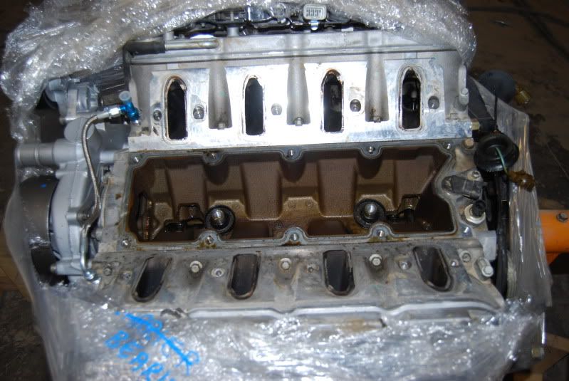

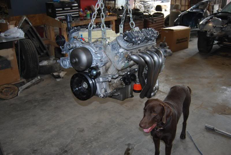

Got some work done today on the car...
Pulled the L33 off the shelf and put it on the stand.
Cleaned it off, and stripped it down to a long block... Going into work early in the AM to get it dressed out with the LS1 bits.

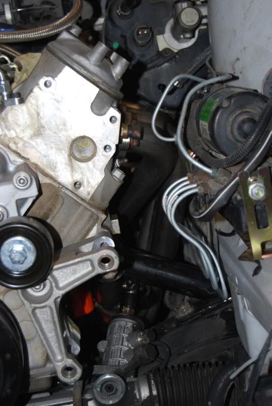

Made some progress on the car last night!

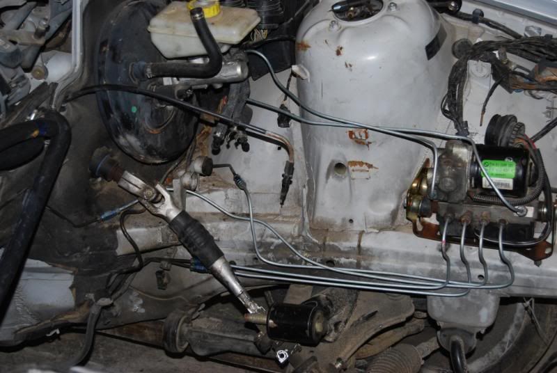

Brake lines are routed, need some more fittings...
Got the last of my brake fittings this afternoon via carquest

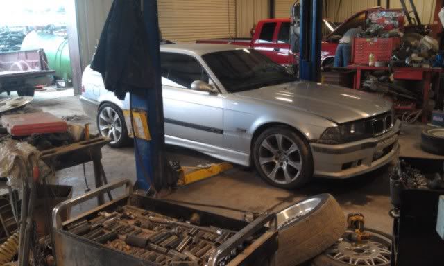

Car is finally prepped for the engine.

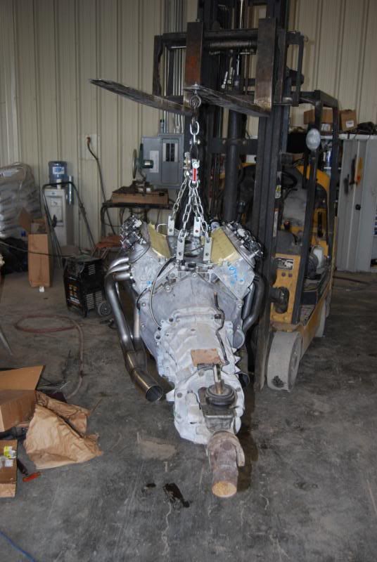

I then got the ls7 clutch installed. The trans qas very easy to maTe. Eric I have no idea why you had issues.

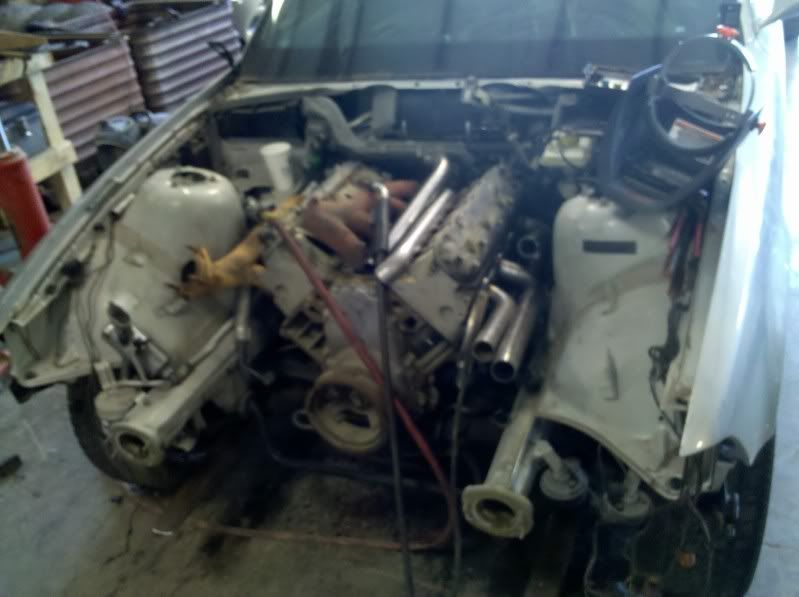

Shoved the motor in first with headers... no go. I didtry to install with headers but they were not going to fit... so it went in without headers.
Then busted my finger trying to wrangle them in... not real sure how those are going to go in....
Any tips on header install??
Yes now that you mention that... sounds like a very viable option... ill try that as well.

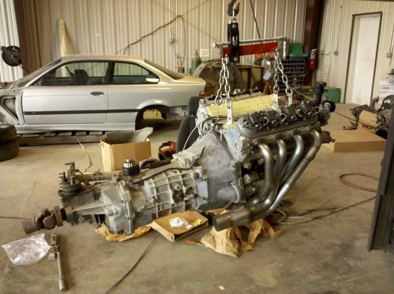

Header Fitment:
The dog next door Pete decided to come by - He's awesome.
Engine bay prepped ready for the motor to go in for the last time. Everything but the throttle cable is in place - should receive another one in a few days.
Car on the lift ready for the motor:
SUCCESS!
Oh yeah notice the not actually trying to fit the headers in there... I got some grief for that this AM when I walked into the shop!
As always you can check my site: http://lsxe36m3.com/
[quote=birdman2447;22751815]I just installed mine today, it only takes a hour or so. I tried to install them from the bottom up but no luck, so this seems to be the only option. First install the driver-side, to get mine to fit i had to remove the 4 subfame bolts and with a hoist move the engine to the pass side by 2in. Then the pass side is a breeze, just pull the starter and drop in down, before you bolt it in re install the starter. Both sides seemed to require the valve covers removed. Let me know if this works for you.[/quote]
[quote=Tongboy;22751857]wow, that is a lot more effort than mine required - granted, different headers but still, they are very similar.
I don't have to remove starter or valve covers - the motor remains bolted into its final destination and they go in from the bottom with some finangling and swearing but without too much weird effort assuming all the little trim pieces were removed from the block.[/quote]

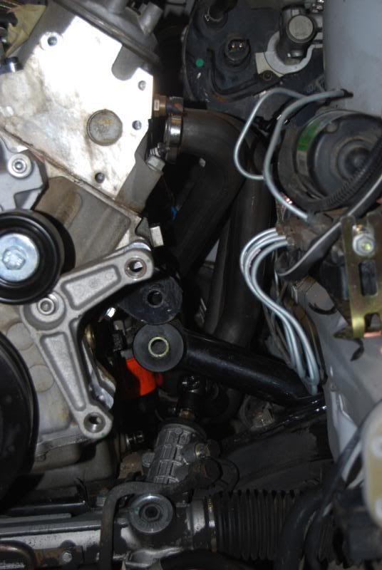

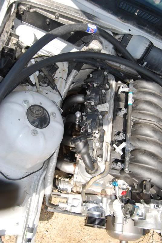

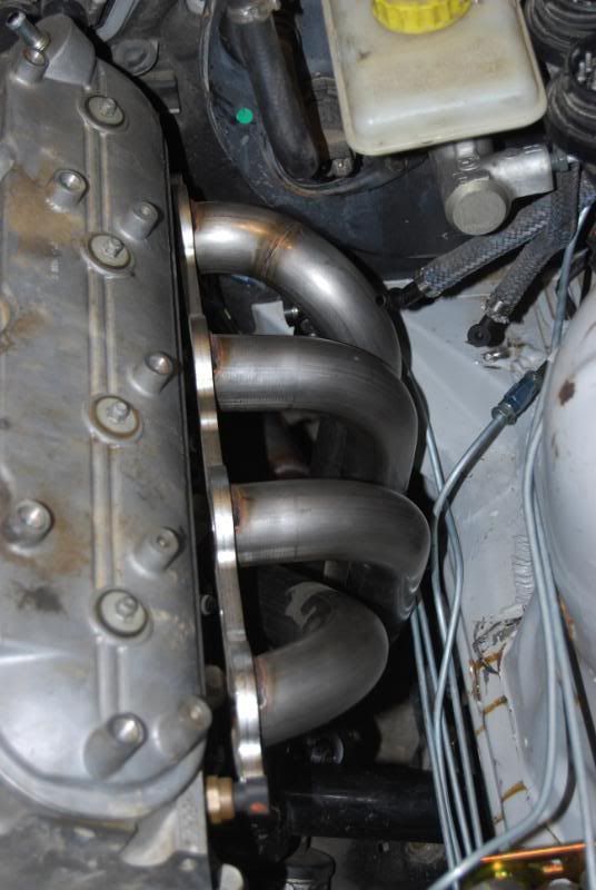

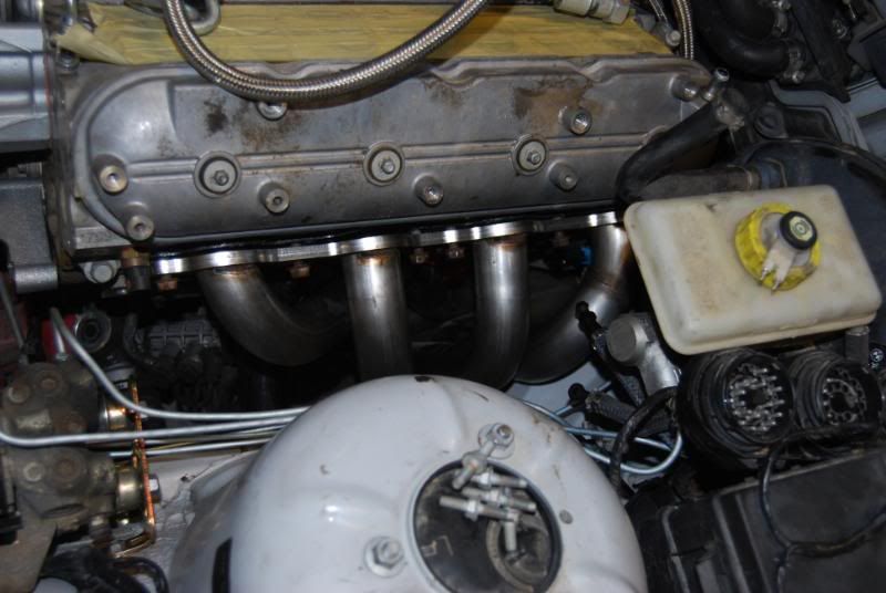

Ok So I found a VERY simple solution on the drivers side header...
Simply un-fasten the through bolt on the mount and jack up the motor 3" slide header in and let it back down. Re-bolt. This process took literally 15 minutes from beginning to end. No cussing. So Easy!
Fitment is AWESOME!!!!!
Tomorrow morning I throw in the passenger side. Pics in the morning!
Driver side header install
Aprox 15 minutes.
Tools needed.
Jack
Hammer
large prying device
large punch
* Loose Motor Mount
* Place jack under oil pan sump remove pressure from mount
* Knock out bolt
* Raise Motor up 2 to 3 inches.
* Slide header in and start two header bolts.
* Re-position motor and mount.
* Slide bolt back in.
* Tighten down.
Motor at installed height:
Motor mount secured:
Fitment is REALLY good.
The only header bolt that will prove to be interesting is the furtherest one back behind the booster. However it was cake with a ratcheting 13mm wrench.
*BRAKE LINES WILL BE RE-ROUTED*

[url="http://www.nicindustries.com/high_temperature_coatings.php?phpMyAdmin=v085d1Xlej-S9bKII5j2WIDX6m5"]Creakote's Web Site[/url]
[quote=bimerok;22760988]I ran both of ours on the "top" of the frame rail and that gave enough air clearance to not have any issues even during 100+F track days.
Image[/quote]
That is what I'll be doing this evening.
Alright! It's lunch time so I'm including pictures!
Here's Fritzintn's 95 M3 with Built S50 turbo, blah, blah, blah, Faster then my LSx M3.
Lazy day at work...
Got off the phone with Cerakote
Here is some tech data and some "tests"
Exterior should be sprayed with this:
http://www.nicindustries.com/images/techsheets/C-7300%20Black%20Velvet%20Product%20Data%20111708.pdf
Interior of headers should be flowcoated with this:
http://www.nicindustries.com/images/techsheets/W-209%20Insulkote%20Product%20Data.pdf
Tests:
http://www.nicindustries.com/images/subpages/File/Microsoft%20Word%20-%20V-171%20Comparison%20to%20Heat%20Shield(1).pdf?phpMyAdmin=v085d1Xlej-S9bKII5j2WIDX6m5
http://www.nicindustries.com/images/subpages/File/Microsoft%20Word%20-%20C7400%20SC%20as%20Thermal%20Barrier%20for%20Class%208.pdf?phpMyAdmin=v085d1Xlej-S9bKII5j2WIDX6m5
http://www.nicindustries.com/images/subpages/File/Microsoft%20Word%20-%20V-171%20as%20Thermal%20Barrier%20for%20Ford%20Exhaust(2).pdf?phpMyAdmin=v085d1Xlej-S9bKII5j2WIDX6m5

Radiator shroud to fit the stock style radiator - will be replacing the no name brand fan with a quality flex-a-lite.
Then last night I tackled pulling out the black dash and carpet from the M3 in a Box as I lovingly call the now parts car.
Excuse the mess in my office...
It WILL run by the end of the month....

I do have a problem with the fuel pressure regulator.
Symptoms are as follows:
*5psi MAX with first prime
*When Cranking I register 5 PSI
*When the return line is crimped prime is to 60psi
*With return line crimped Running fuel pressure and starting fuel pressure are right between 58-55 psi.
*Take off clamp on return line pressure quickly returns to 5 psi.
*FPR is not plumbed backwards - I originally thought that and checked it.
This FPR is brand new, should not be having problems with it like this. Has anyone else had issues or did I just get a dud?

Worked on the car last night.
Got the o2 Sensors installed hoping that would make the car run better - not so much. Have a miss that can't seem to find.
Installed my radiator and noticed right away that the cooling fan isn't going to fit.
Now I'm in the market for a slimmer fan....
I'm good thanks for the offer, had to weld something up as I needed to use the stock fitting and mate it to a 4AN fitting. It's all good now. Pressure tested at a hyd. shop and ready to install.
Pictures of my booger welds:
according to real oem there are a number of different Clutch master cyl and line configurations.
There are at least 4 known...
Early threaded type.
Early clip in - tried the braap modified line in my '95 master and it was a no go as well.
Braaps' clip in
Late clip in

I have a Summit Racing 3″ universal x pipe, Spintech Sportsman XL Muffler with dual 3″ inlets and dual 2.5″ outlets.
Other then that we’ll see what happens with the exhaust this weekend.
I am also hoping to throw in a factory core support and get the front end all put back together and properly aligned. I have new headlights and corner lights ready to throw in as well...
I also have put aside a few different cooling fans so that I can mock them up and see which ones fit the best. That should help with the engine temps, though it does not seem to get warm as it is…
I sure hope that the exhaust will get rid of the stumble I’ve been dealing with!
Next on the list is intake plumbing, I need to get that sorted out and figure out if I am going to go with a speed density or maf tune.
All in all everything seems to be coming together quite nicely and am excited to get some more work done on the car.
UPS just dropped this off:
updated the blog as well.
http://www.lsxe36m3.com
Spintech Exhaust is on the car, lots of butchering of the x pipe to get it all to fit, but it's in there!
Car still has a stumble that I can't figure out... It may be a wiring issue... I am going to go back through my harness to figure out what's up.

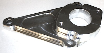

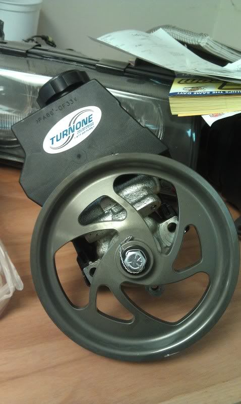

Come to find out the OEM PS bracket is NLA from GM....
That is exactly what they do. They buy new (not reman) pumps for the OEM application and modify them to not run so hot and voila you have a turn one pump. It was more cost effective for me to buy their pump then buy a reman or new pump from the local parts store then try to figure out how in the world to modify it.
Since the stock bracket is NLA and I don't feel like wasting time trying to source a used one, I grabbed this from the sand rail guys at Alper Motorsports.

Started at the shop around 7am this morning.... Shocks on the Tahoe which surprisingly only took 20 minutes! Then I went on a quest to find a stupid state inspection sticker. Good ole Scott at Mathis was the man in getting that done!
Got back to the shop and tore into a 318ti we have to grab the radiator support and nose panel.
Tore down the M3 to get rid of the aftermarket crap that I had on there.
Put the real deal stuff on and MAN the body panels ACTUALLY FIT!
Installed the Depo headlights with 6k HIDs.... Man starting to get somewhere.
Installed new o2 sensors, cleaned up wiring, and made an upper radiator hose that actually fits with my new intake ducting. Part numbers come Monday on the hoses.
After that I swapped some wheels and tires around to get a full set of tires that hold air. Come to find out Style 5 3 piece BBS wheels do NOT fit front M3 brakes. MERF! I need about a 10mm spacer to make it all happen.
After that I bled the cooling system and she stayed nice and cool even without a cooling fan. I love the BMW cooling system, it just works! I will be adding a fan soon enough. I have found a couple BMW fans that look like they might fit the bill nicely.
Took the car for a drive behind the shop... She did well in the lower RPMs or when ever you don't put your foot in it too much. Smooth and quick. When you roll into it or floor it the car breaks up and what not... I don't get it. Also at idle, it's pig rich.

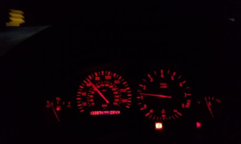

Cluster shot from last night:
1500 rpm @ 70mph in 6th gear
Time to re-gear but I would imagine the gas mileage is AWESOME.
