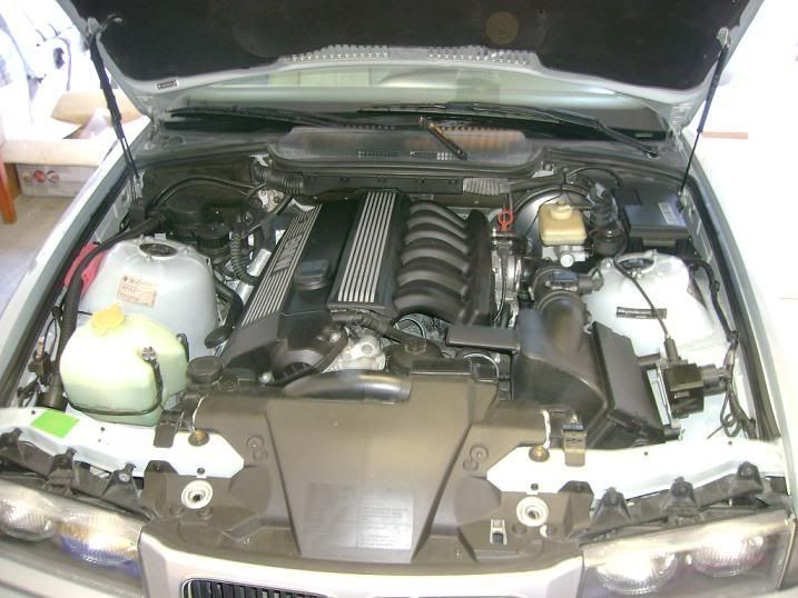

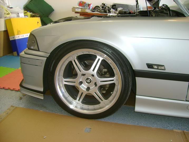

So it has started… car is a 1996 328iS all stock with 96.5k on the clock.
Started at 10am PST and finished 1am with around 2.5 – 3 hours total break time (food, beer, cigarettes, on-line/phone parts ordering, and some chit-chat)
This was my first time so almost all credit goes to Stan (Godfather), Marc (Strad), Jessie (JDizzle)
What we accomplished…
Took out front exterior pieces
Removed Intake Mani
Removed Entire Cooling
Removed Valve Cover
Removed entire exhaust
Removed Cams
Removed Head
Installed Intercooler
Cut bumper support
Cut bumper cover
Removed Tranny
Installed m3 flywheel & clutch kit
…thread will be updated regularly
Here are some pics… any comments/advice/criticisms are welcome and much appreciated… sorry for crappy cam… all I had available…

Postby fcvapor05 » Thu Aug 14, 2008 5:34 pm
Nice progress. Your head and valves look to be in pretty awesome shape.
M50 Manifold going on?
